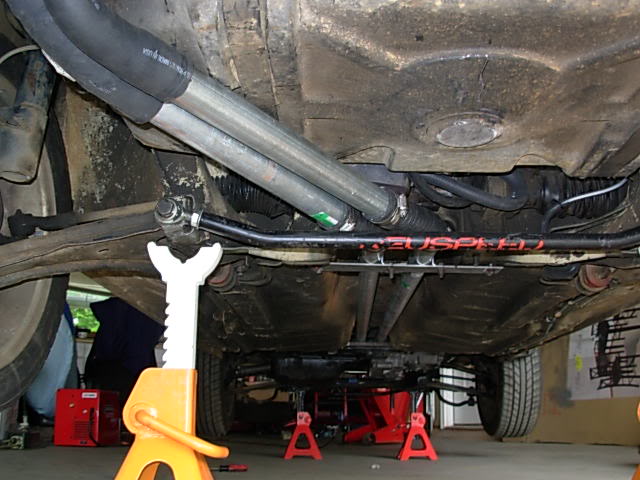

check this out, i'm still a member of this site but i sold my rabbit about a year ago, this guy mounted the engine in the rear and the rad in front, this pic is from page 3
You can see the build here
http://forums.vwvortex.com/zerothread?id=2688128&page=1
HTH!
