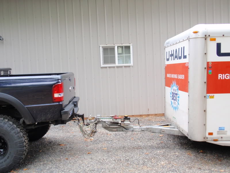

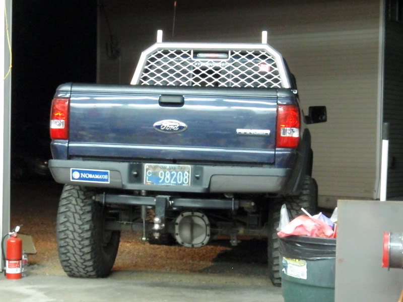

The hitch is not an issue, to me anyways. Here's a pic for ya

yours doesnt look that bad at all, the hitch i have may not look that good (ford hitch) i want it to look as clean as possible because this truck will be in shows... oh and i LOOOOOOVE THE BUMPER!

I thought about the hitch hanging down as well, but after I installed it, it didnt bother me. Plus, I can hide the hitch with this...

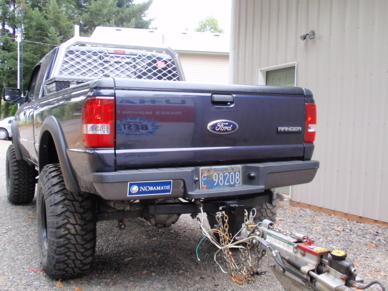

The bumper 'not fitting right' that your seeing is that the brackets push the bumper forward some, so the line up between the flares and the bumper looks 'notched'. That might be what your seeing.
Your towhooks will either need to be removed, or the valence will need to be cut. I understand there's a 'Michigan Only' towhook mod that stone might be able to tell you about. Works with the 3" bodylift.

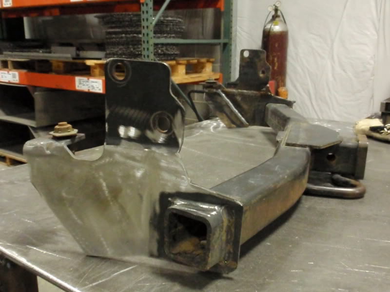

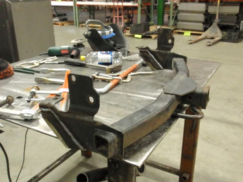

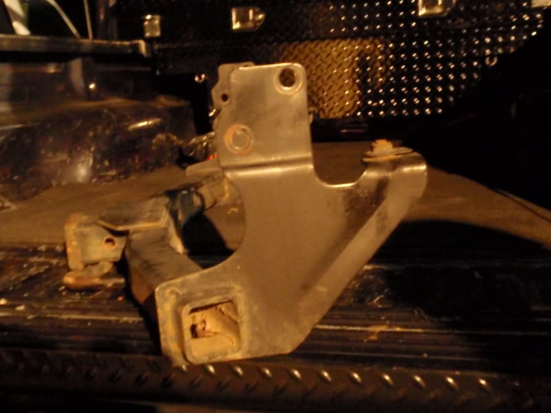

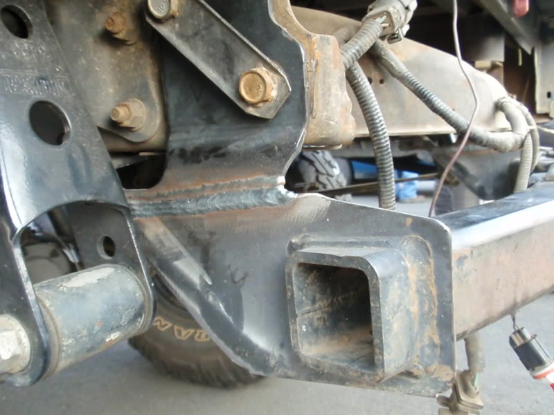

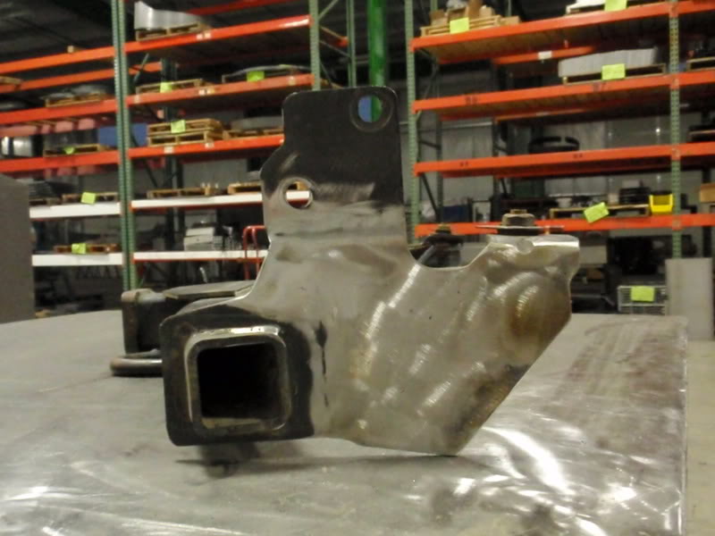

Here's my lifted hitch...
Took a 2.5" chunk out of it...should have went the full 3" now that it's installed. Used every piece I took out of it to add strength...towed a 3,000lb loaded trailer for about 300 miles, no cracks. Will likely take it off and add reinforcement where the main welds were though.

I have done what shane did, i too only did 2.75 and wished I went with 3" but it still worked out fine.
I did mine a little bit differently though.
After cutting out the 3" like Shane did I then ground down the weld on the hitch tube and slid the sides in about a 1/4" on both sides, then welded them up, this allowed an over lap so i could get 2 different weld passes per side making it stronger.
