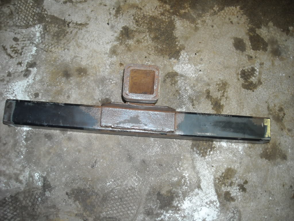

I picked up this rusty beauty off of craigslist on Sunday for $25. Its a rear hitch off of a 1998 Jeep Grand Cherokee. The guy I bought it from was actually planning on modding it to go on the front of his Jeep Wrangler, but he decided to just drill a hole in the mount for his plow and put a ball in there. So I drove 25 miles to pick it up.
This hitch works perfect to mod because it has a straight bar, and the reciever is mounted below the bar instead of in the bar. Also the mounts are big enough that I can use them for the new mounts and not need any extra stock.

First I cut off the box that held the trailer wiring harness and the hoops for the safety chains. Since I wont be using this to tow on the highway I wont need safety chains.
After that I went to town with a wire wheel and a sander. I cleaned it up a bit. Its not down to bare metal but I cleaned the powder coating that was flaking off and some of the loose rust. After its all done I will hit it with a rubberized under coating and some por-15.

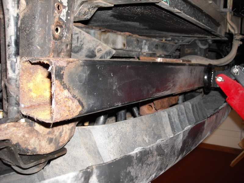

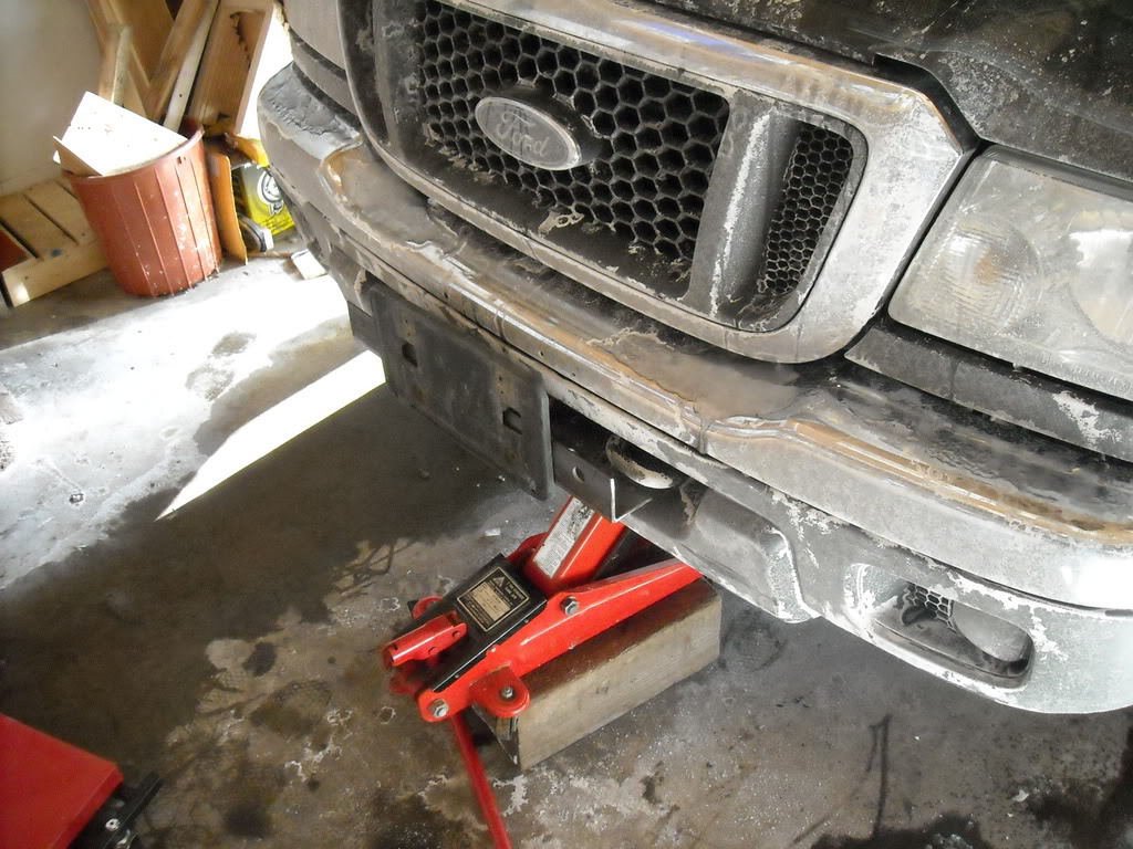

Got a "dry fit" in to take some measurements before I start trimming the brackets. It will sit about 1/4" lower and about 1/2" further back from where it is. I hope to get it all ready to weld by thursday afternoon. I also need to cut the bar to its final length after I do a bunch more measuring. My motto is "Measure 36 times, cut 4 times"

If I had a use for one then I would build one, But im actually building a light bar and a licence plate holder to stick in there.
I'm building it to help move our camper into our back yard easier (8'wide, 9.5' hole)

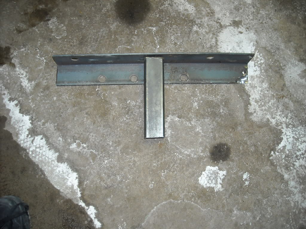

Ok the latest updates:
It is getting welded up in the morning. I finally got every thing finished, and today I just had to run downtown to pick up the steel for the light bar and the license plate holder
Bar:
Mounts:
Unwelded final product:
License plate holder (needs to be cut down but I ran out of cutting wheels so it will have to wait):
Light Bar:
