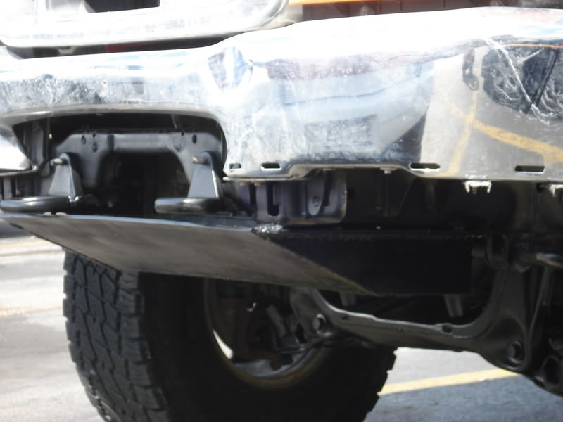

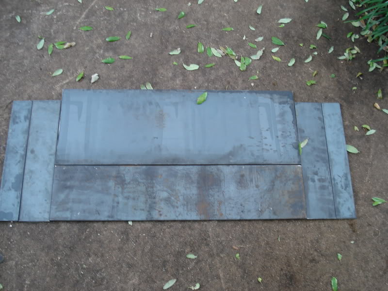

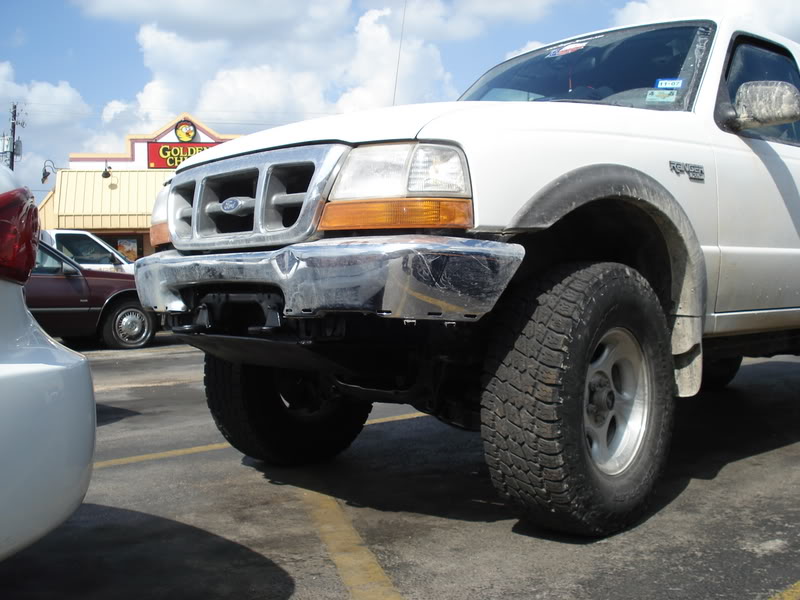

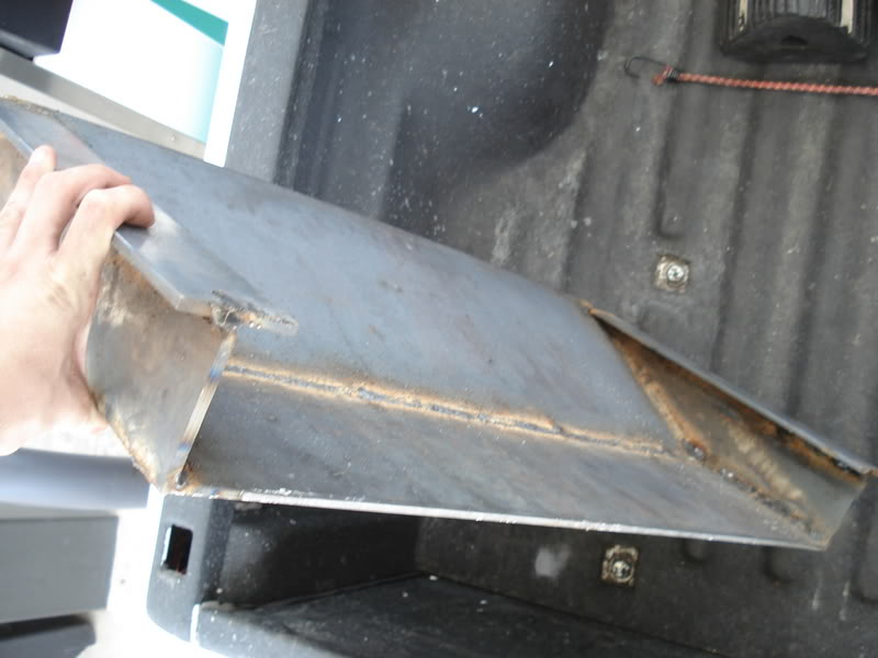

so the last few weeks i have been busy.. kinda

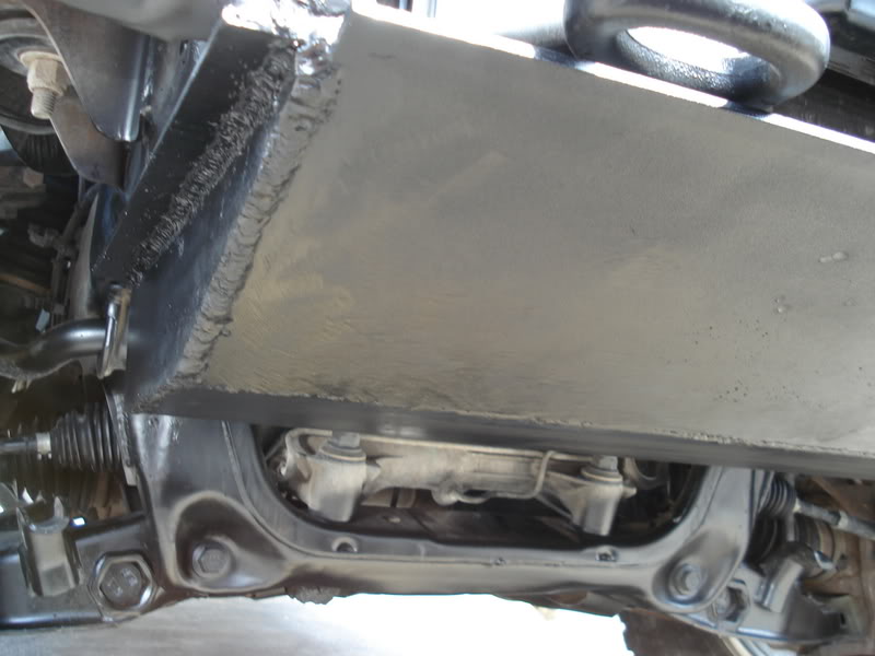

made my skid plate, for those of you who haven't heard, i convinced my self i needed one....the hard way

it didnt mount up flush like i wanted it to.. but w/e

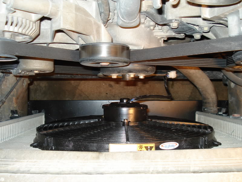

e-fan.. 16" TorqFlo

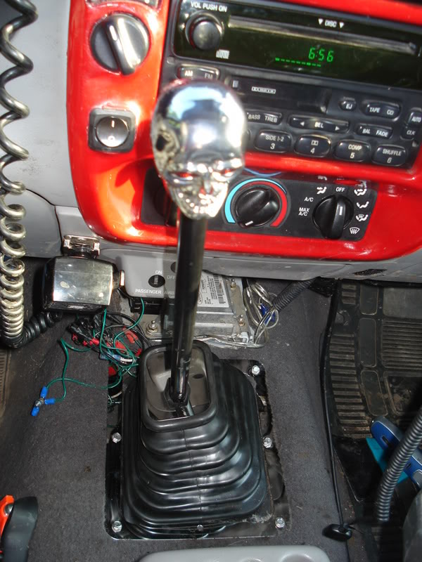

fixed my shifter.. im done with it for now, except for an 8 Ball
i need to clean up around the bottom and get those wires outa there..

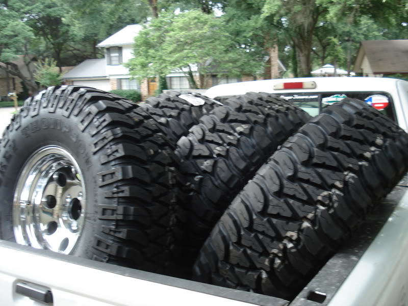

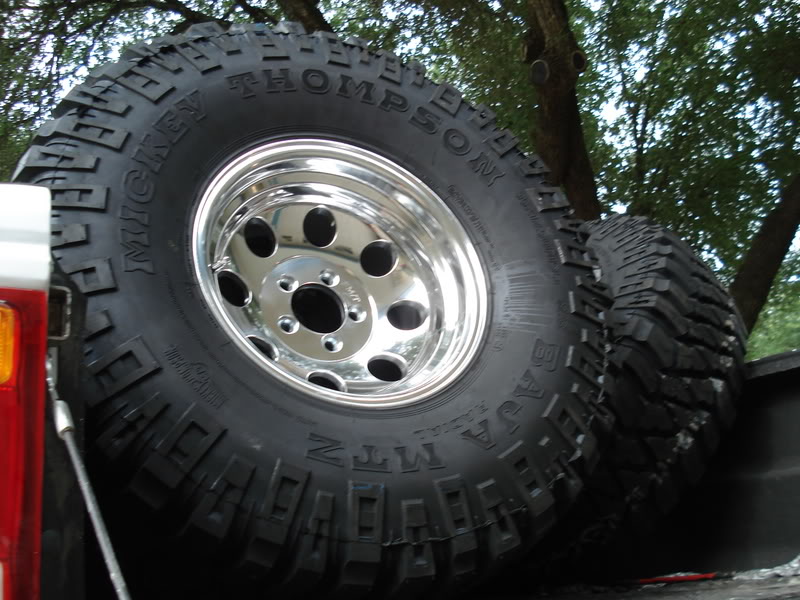

oh and i almost forgot... i picked up my 35s :D
i got the 35x1250-15 Mickey Thompson MTZs and 15x8 Mickey Thompson Classic IIs....

let me know if that e-fan helps any

i got 16 highway... heh
o and i painted the cross memeber while i was down there painting the skid plate, i think it looks better. That and the front of the truck better now.. you cant see the radiator and condenser hanging down

Nice tires

Like I told you on SAO, Matt, nice skid plate. I may get the dimensions off yours sometime, so I can throw somethin' together for my truck.

Nice new toys! I am jealous of the 35's and lift!
(2) 3.5x15
(2) 2x15
(1) 10x29
(1) 6.5x29
all 1/4" thick
but since you dont have the body lift, and your radiator doesn't hang down, you could probably make the 3.5 a 3 or so...

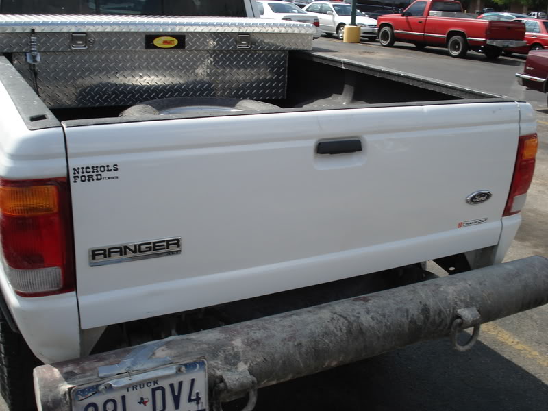

Dude new rear bumper! I'd rather be raped by mexican apple farmers than have that thing on the back of my truck!
Did you get rearended? Rear square steel bumpers aren't hard to make, other members have made them.
Old Jun 12, 2007
hahaha, the bumpers a few months old actually.. and im waiting on someone to hit me..
the pipe was free, and its on there because i backed into a Mercedes.. just bent my old bumper a little bit, f'd up the car tho..
