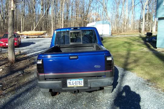

I just got done blacking out my tails with vht nitshade and damn does it ever look good.

Looks real good..
I like that didn't black out the back up light...
Looks clean

Looks good. I did it for my tail lights as well, but damn yours are dark!

It cost $15 for the niteshade w/shipping, $5 for the rustoleum gloss, $3 for 2" 3M blue painters tape, and $2 for some 400 grit wet sandpaper. All in all you can do it for $25 and two hours of your time. Which is mostly sanding and waiting in between coats. It took me an extra couple minutes to tape off the reverse and third brake light. It's definitely worth it. It really sets off the rear end of my truck. *TIP* Practice the niteshade and gloss on cardboard or something. Runs are a b1tch to sand down w/o noticing on the finished product.
