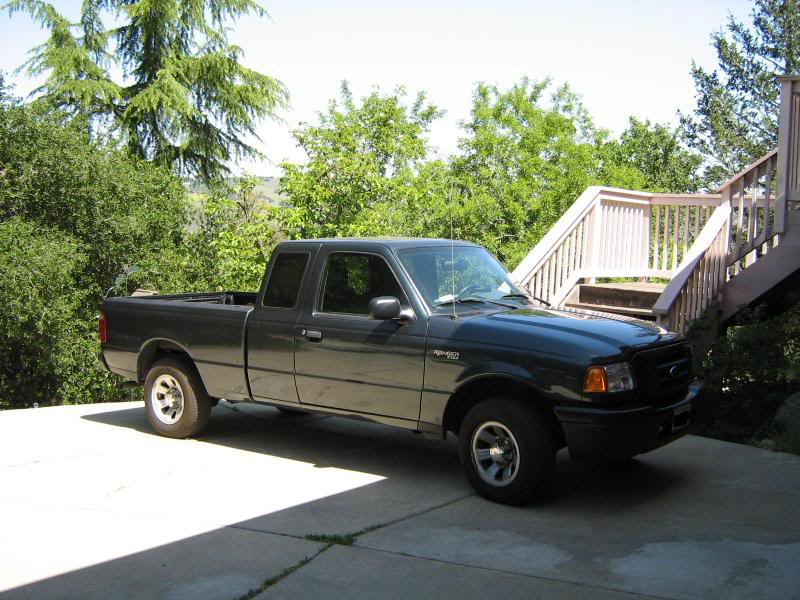

04/16/2008 Upgrade: RECON White Lightning
A little dirty so I washed her first

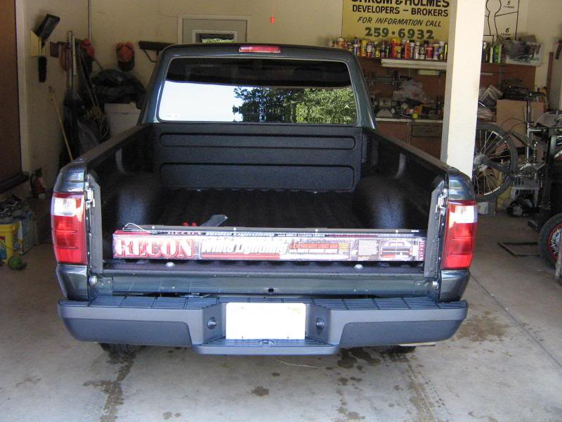

And now the Install!!
Cleaned the surface some more and final prepped for mounting with an alcohol pad that comes with the kit. Now getting it all lined up. Used a tape measure to line up all mounting points. But the led's on the strip are not perfect so eyballing it to the center is all you can do. Before I mounted it for good. I held it up using some tape; then hooked up the wiring. I tested it out and realigned it to my liking. I then put some blue tape right above the mounting base's and made sure it was straight as I could get it. Drew a line to resemble where the mounting point is going to be. I did the inner to first and removed the tape. I lined it up with the tape measure first then after everything was all set i put her on! Then the same process for the outer mounting points. I removed the light bar and got some crape pieces of wood and pushed a little harder to get that bondage!

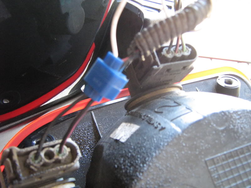

White wire is for the power to the reverse light. Popped off the drivers side brake lens and tapped into the black and pink wire.

What I love about this kit is that it's pretty much plug and play. I could have just Tapped into all the wires I needed to, but that's to hard! I used the 4 pin trailer/brake light connector that I didn't know I had. Just plugged it right in!

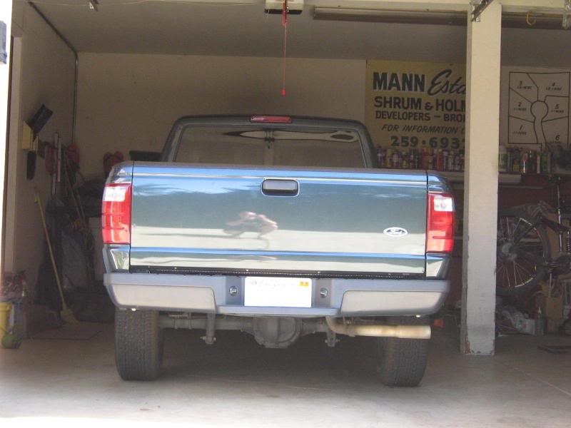

After tucking all the wires up with zip-ties and getting it all done you have this as the final product!
With out Tailgate.
With Tailgate on. As you can see it's pretty much hidden. Unless your in a lowered Honda you can see it. But it looks good and clean.

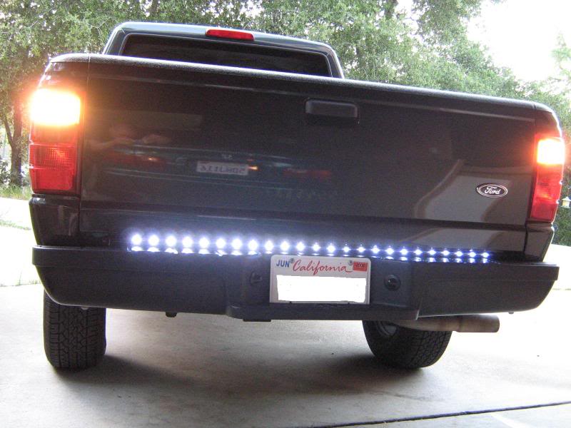

Now some action shots. (HaHa at my reflection!)

Like I said before it was very easy to install. Now I know I wasn't going to expect it to produce much light at all, but the whole point for it is to act like a running lights in the rear. I may upgrade to some 06+ taillights and throw in some LED bulbs to kinda match the light bar when in reverse and not to mention the 06+ ones look sweet! Now that I notice my bumper looks a little f*#$!ed up. A little crooked maybe? O well maybe I was holding the camera all crooked!!

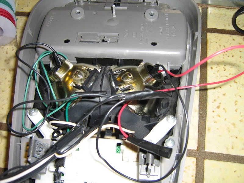

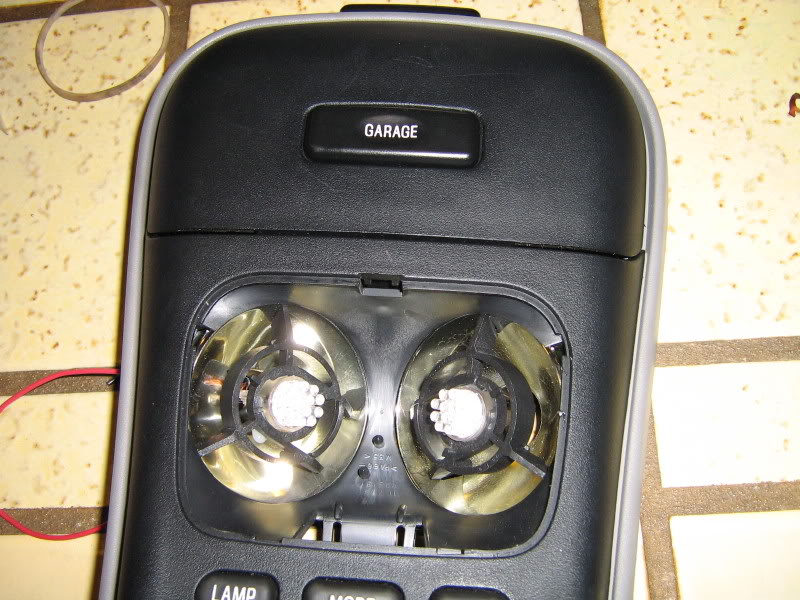

4/19/2008 OHC LED MOD LED Reverse Lights

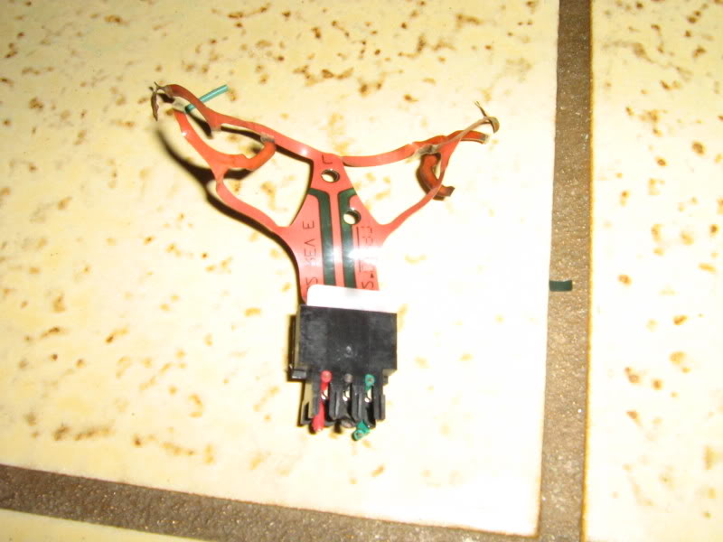

So as most of you guys know that have the OHC the orig bulbs are kinda put in the housing stupid. Mine didn't work to well because of that stupid copper contact thingy. So I rigged up some LED's to it and they work a lot better then if the orig worked. Also got a 25 led reverse bulb and it works pretty good. I ordered from superbrightleds.com ( I have has bad experience in the past with ebay led's.) Anywas they did send me one bulb that was the wrong color so I have to send it back. But o well you get the idea of it. Soon my reverse lights will match the White Lightning.
stupid copper thingy!

is it just me or is that LED light bar unlevel? it looks closer to the top edge of the bumper on the pass then the driver's side.

Yea it looks like the led light bar in the rear is not perfect (I may have been taking the picture crooked too perhaps.) but it's more or less the leds inside the tube are not even and perfect in a straight line. I measured and eye balled it to the best I could and I think the bumper is not lined up correctly. I guess its a multiple things that make it look un-even.
