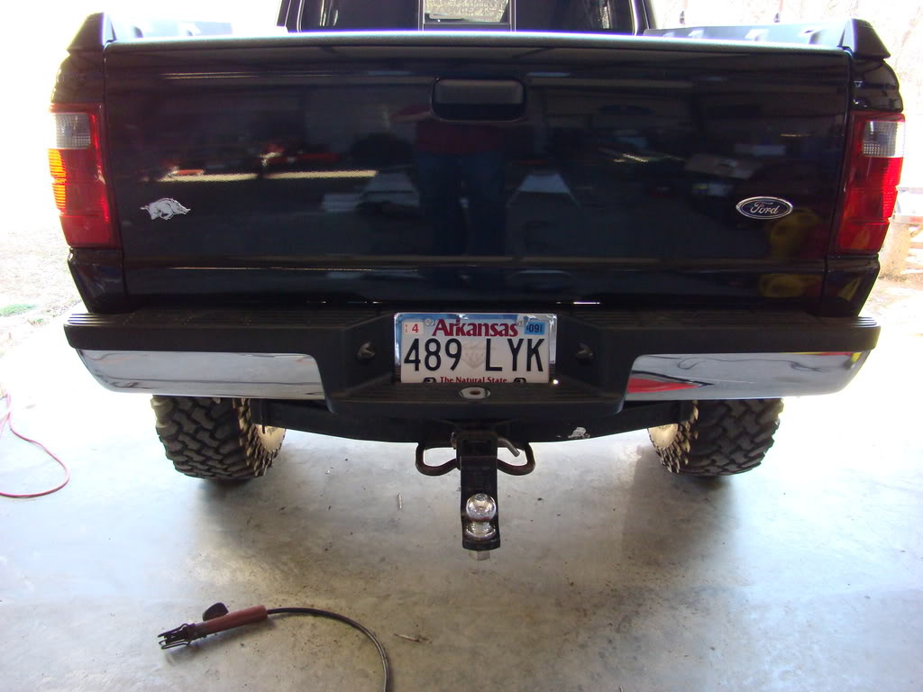

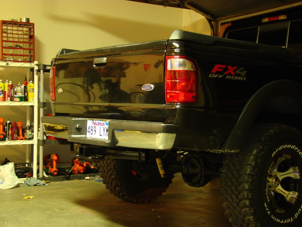

Step One:
Mount the hitch you purchased or currently have. Measure from the bottom of the hitch to the ground. Make sure your on level ground and tire pressure is equal.

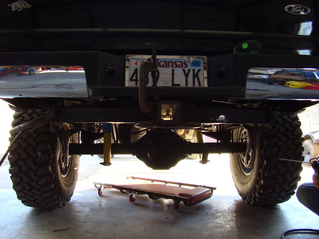

Step Four:
Using welder's clamps, align hitch with the bumper, measure on level ground from the bottom of the hitch to the ground. Check to make sure you have equal distance on each side. Make sure to get all angles in alignment. Use Clamps to hold the hitch into place. Take your time doing this, try to get it straight as possible. I moved my hitch up exactly 3.5 inches. CLAMP IT TIGHT!

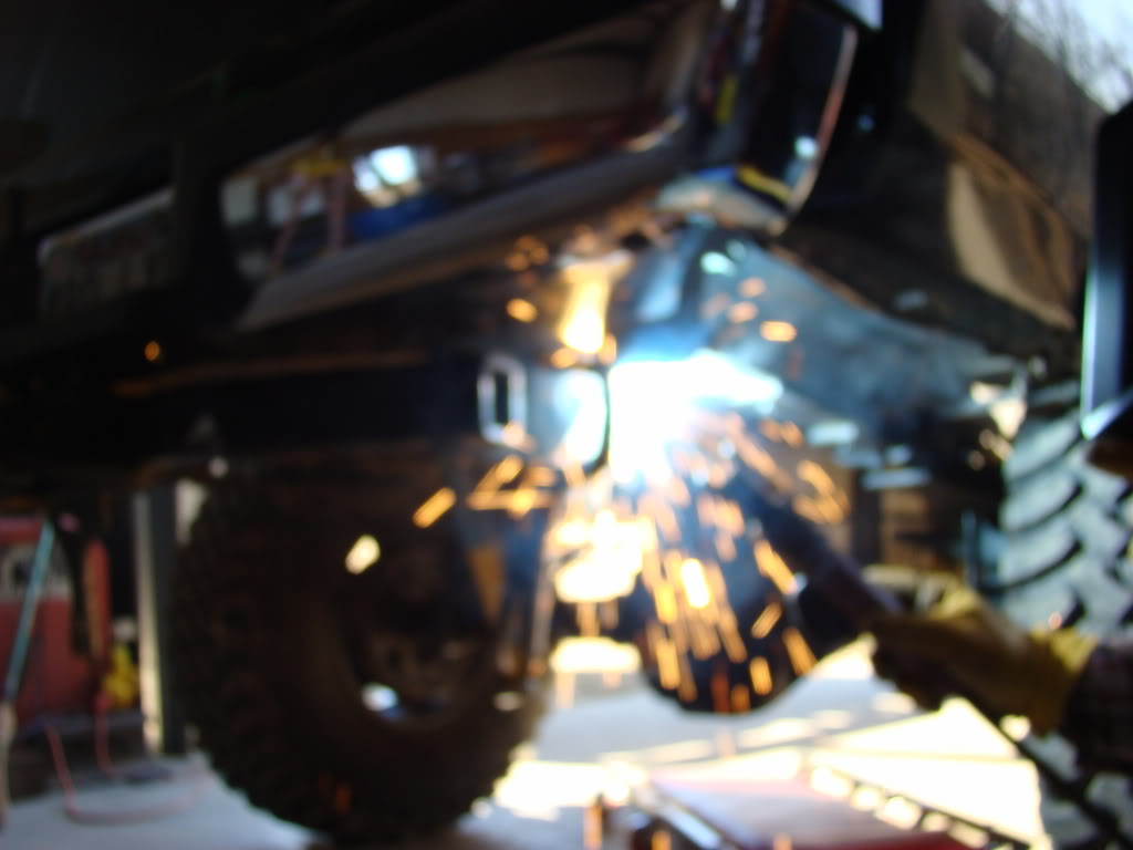

Step Five:
Using A Welder, tack weld the hitch into place.

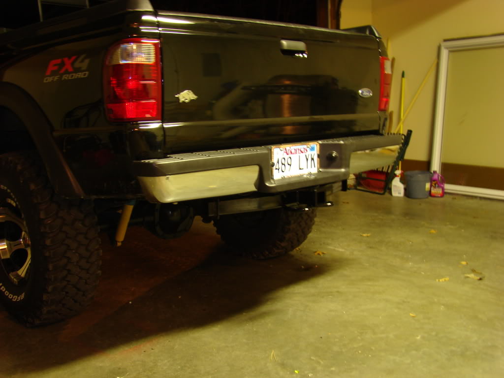

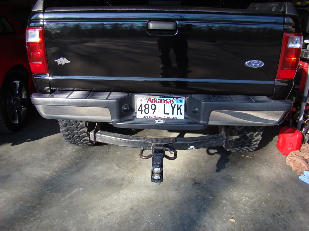

Go back and check all bolts, brackets and welds then give that thing a fresh sanding and painting. Here is the end result:
