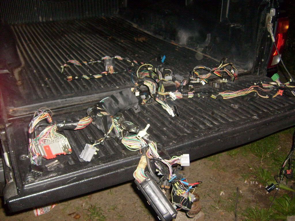

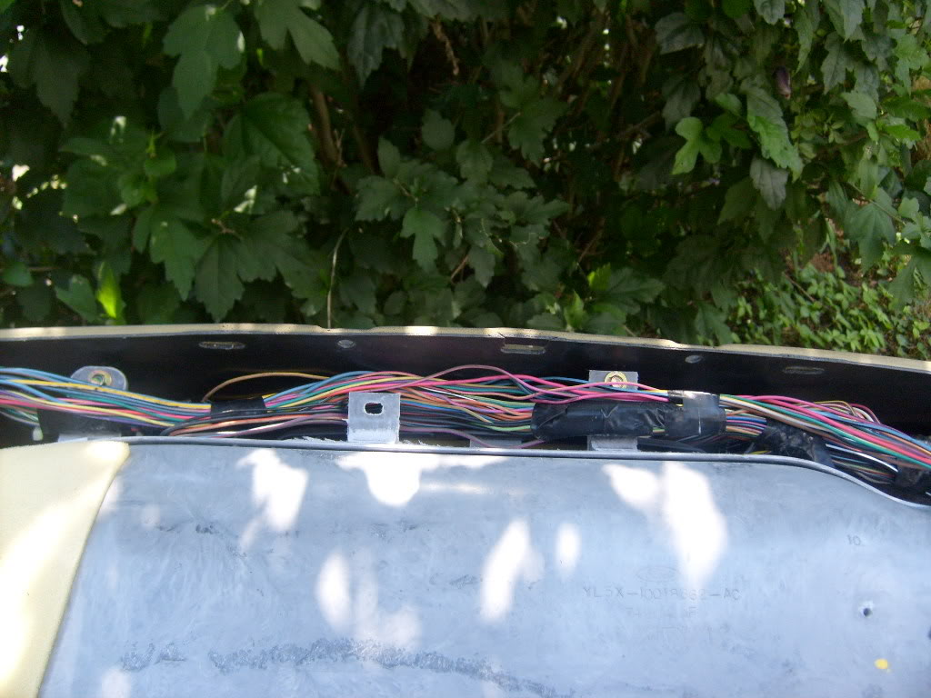

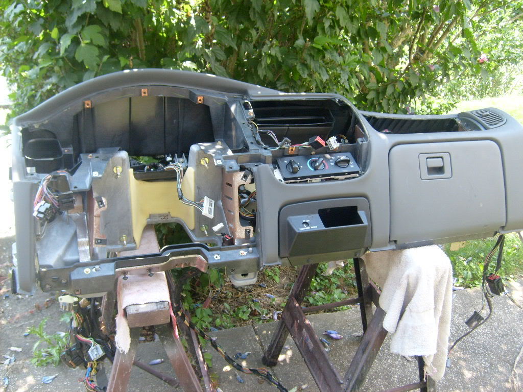

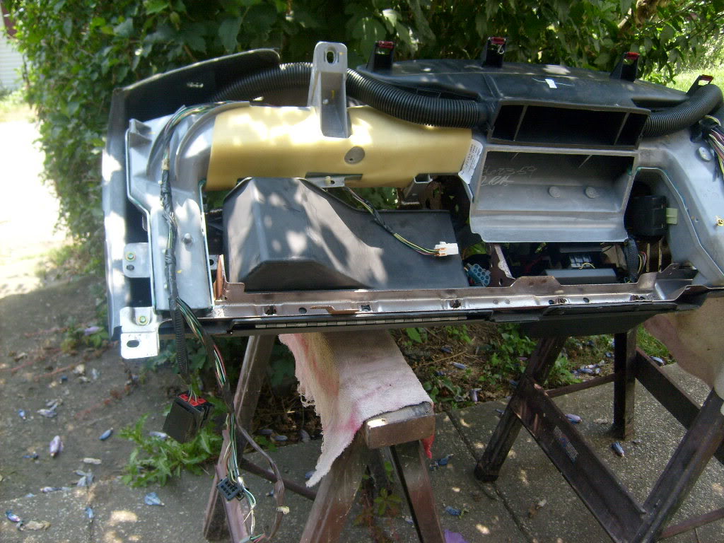

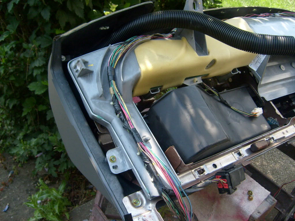

I am not going to cover removing the dash but here is the factory dash removed without any modifications to the harness.

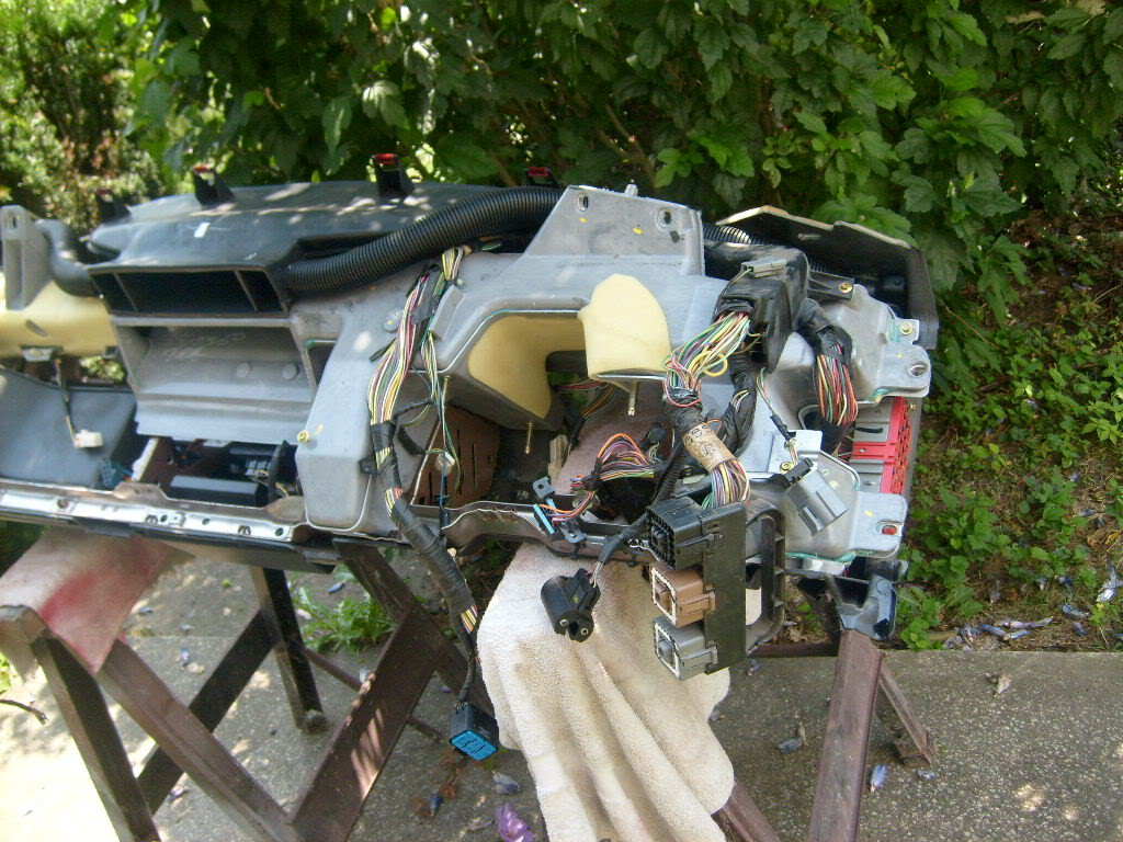

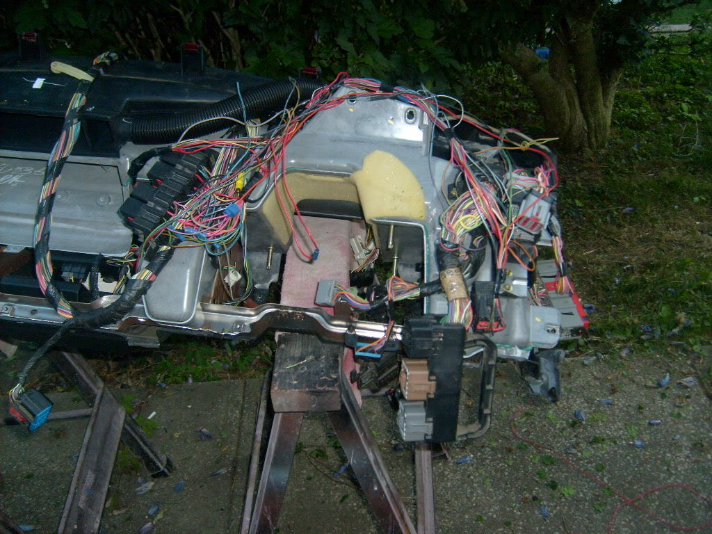

I removed the factory harness from the dash. Note the door plug near the fuse box with only 4 wires on the drivers side.

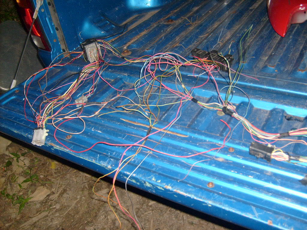

After dismantling the donor harness here is what is required for the power doors.

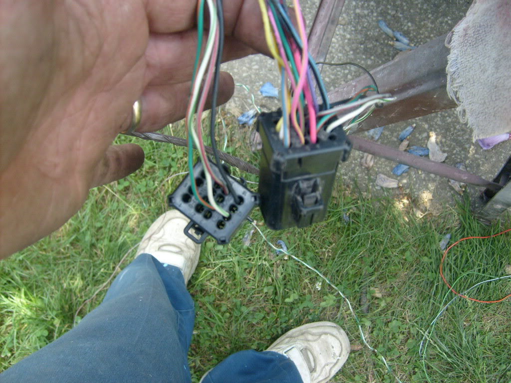

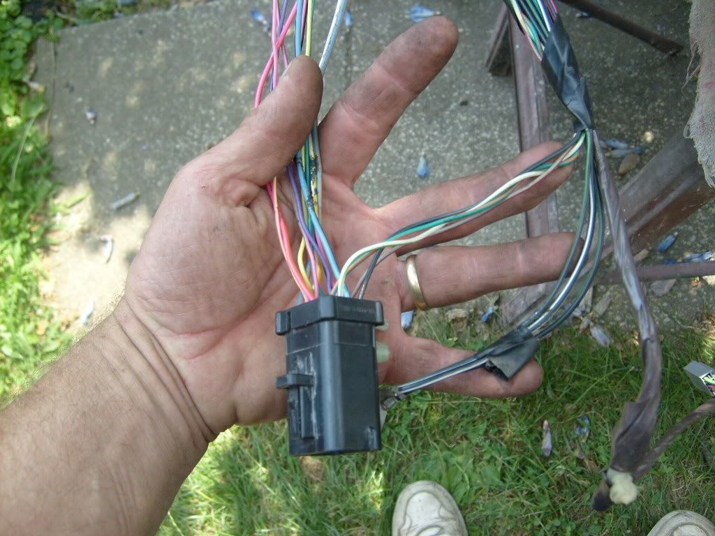

Here's the difference between a power door plug and a manual door plug. Note the wires on the power door plug donor I have folded over, these are already existing in your truck.

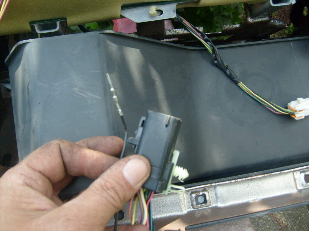

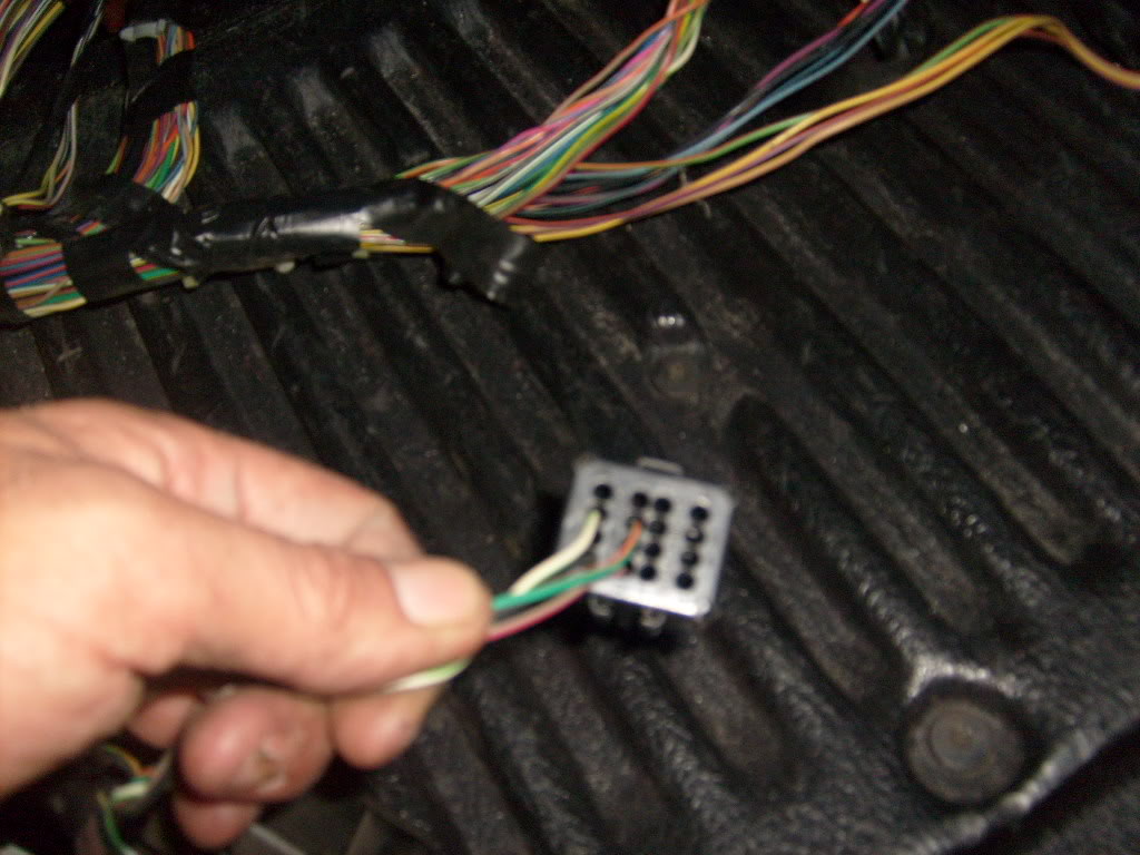

The first step is to remove the wires one by one from the donor harness plug and istall them in the corect position in your factory harness plug. If you look at the picture above you will see a red piece of plastic inside the plug, this has to be removed and then use a tiny screwdriver or scribe to push the tab back and remove the wire. This is what a removed wire looks like.

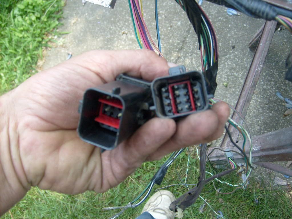

After you transfer all the wires this is what it should look like. Don't forget to reinstall the red plastic lock into the plug. Note the 4 factory wires and the 9 you just added.

You will be required to add this relay box to the center of the dash with 3 mini relays and then 2 other relays. Note the wires going over the black relay box, they go to the gem. The all unlock relay is on the bottom right (note the black relay with red in the plug.

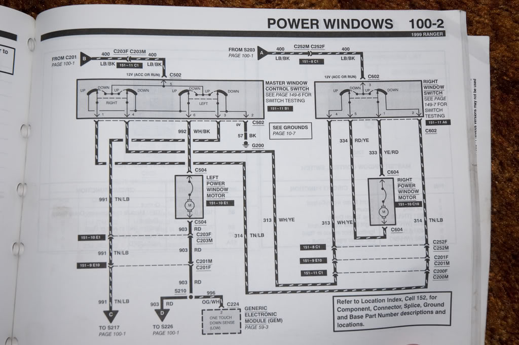

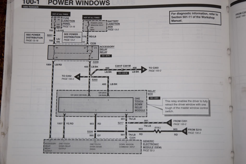

Unfortunatley this is all the pictures I can find so I'm not sure if I have any more but this will get you the basic idea and concept of how to do it. Between these pics and the following wiring diagrams you will have all the required information on how to do it. A big thank you goes out to Ramsey Leonard for providing me with the wiring diagrams.
