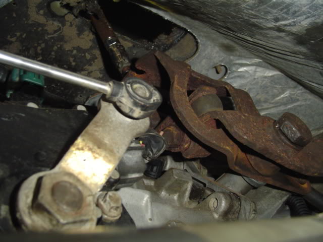

ok, accouple questions
on the ABS, what did you have to change? Do you think an 1999 ABS module off a 4x4 would work? And what exactly did the tech at ford have to flash?
And what did you have to modify the shift linkage? And why?
Old Aug 23, 2007
Originally Posted by 04 EDGE
what are you wanting to do scott?
i had to use a abs module off a 04-05, after installing the module then i found i need to have the IP cluster re-flashed, i have not done this yet, lack of funds.
the linkage i had to mod for the body lift.
do you have AIM?
contact me, imtiredofthinkin
