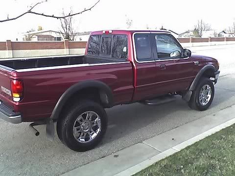

I have a 1999 Mazda B4000 (just bought it a few weeks ago) that makes a whining sound when I turn the steering wheel on my truck while sitting in my driveway or a parking lot. I don't have to move the steering wheel very far for it to make a faint, noticeable sound and the more I turn the steering wheel, in either direction, the louder the whining sound gets. I'm sure it's making this sound whenever I drive the truck on the road -- I just don't hear it because of the engine and road noises. I've checked the steering fluid and it seems like it's pretty full and the fluid appears to be fairly clean. I do have some exceptionally large tires on this lifted truck and maybe that's what is causing the sound (I've included a picture of the truck below). It's been making this sound ever since I got it a few weeks ago.
What do you think is going on? Is this normal or not?

Mine is loud also, but seems mechanically fine so i don't mess with it. Your truck is nice man, good find. What site tires/rims are those?
