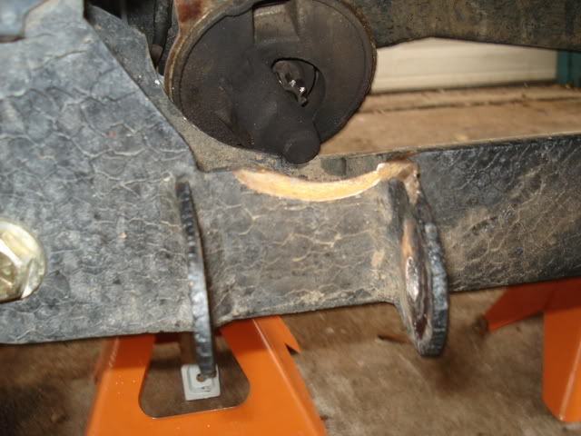

I just want to let everyone know who has the rcd lift to check your drop diff bracket. Mine broke today when i went wheelin trying to flex on a rock. I had to reinforce it with 1/2'' steel and weld it all around. Was not a fun day. But just to let everyone know that it isnt that strong and i would check yours to make sure it hasnt spit yet.

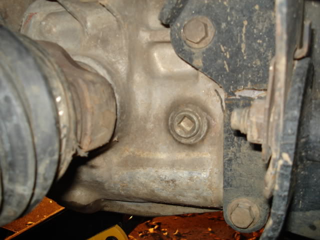

did the diff torque down and round out the cross member?
and i presume it broke right here??

ATLEAST 3 trucks on this site have had it break, thats a big %.. how many people on here have the RCD kit... 10 maybe?
Originally Posted by lifted97ranger
you are the first that i have heard of with this breaking.....AND since you wheel your truck, you add that extra chance of breaking something.....just so happens that you did break something.....
broke mine 2 weeks ago, and its a piece that shouldn't break, not that easy at least..
