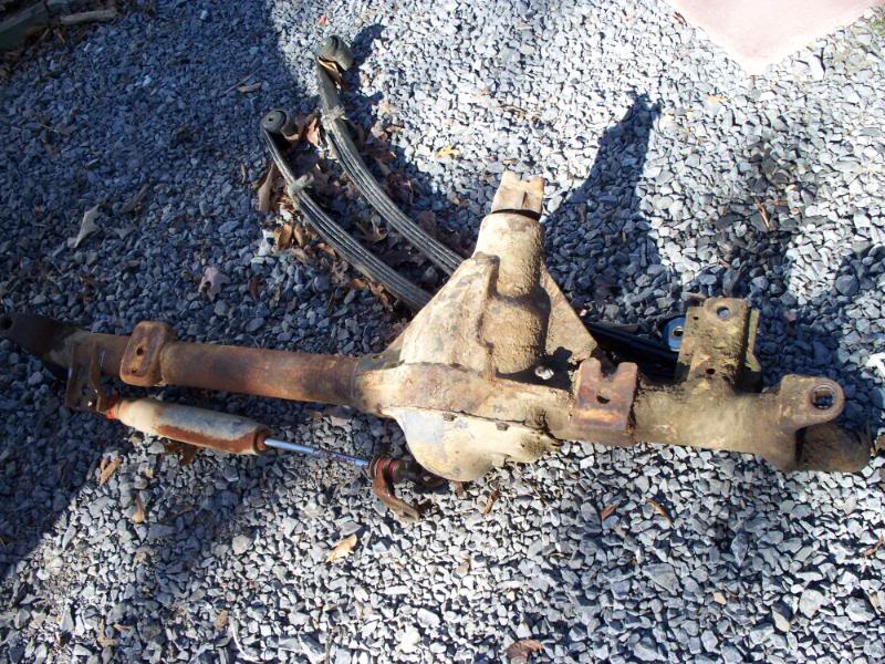

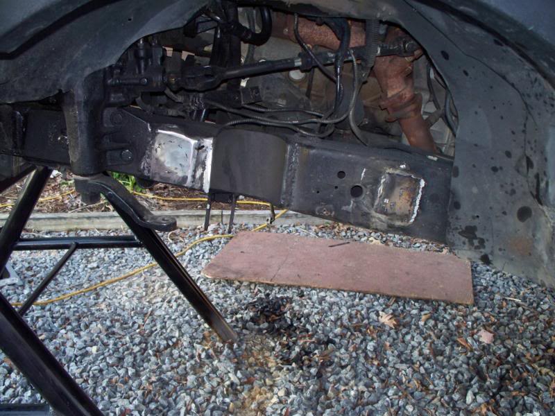

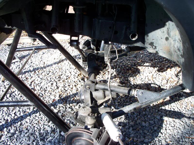

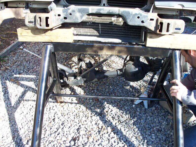

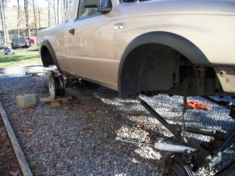

ok,pic time

78-79 f-250 d-44

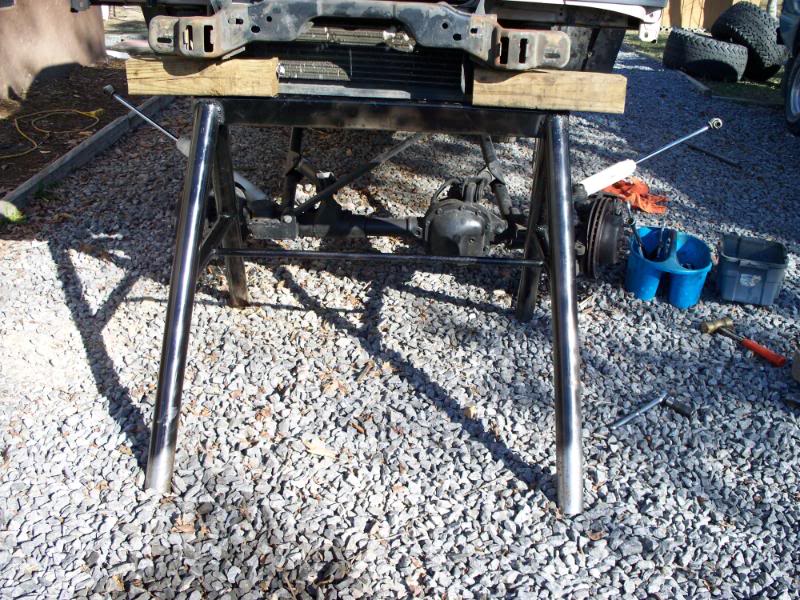

Walt, do you have any pics of your steering / panhard geometry?

here chris some from his build thread
Old 02-12-2008

Yea i would say your angles are a bit steep. I'd try the high steer and maybe lower it down a bit. Try and get your angles as close to flat as possible. Dont give up on the links just yet...

Yea hes switching to a d44 so highsteer is now reasonable option. I agree with this. He already has all the link parts. He should buy the D44 TJ brackets and run what he has with highsteer, should fix his problem.

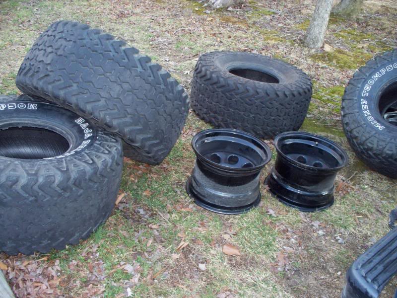

Putting leafs on will not solve death wobble. Death wobble is usualy a symptom of back wheel bearings, out of round or unbalanced tires (yours look shot), bad tie rod / link ends. Have you ever trie borrowing a different set of tires?
