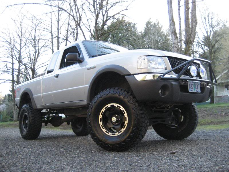

the stock 600's will show bad sag by the time you hit 10k...just so you know....600's are like having B torsion bars....
I vote 750lb coils. Only like $150 max for the pair. not $250 each as previously stated in this thread.
http://www.eshocks.com/hyp_ind.asp?S...=2Q1&SubChar=Q
check out the bump stop clearence....
