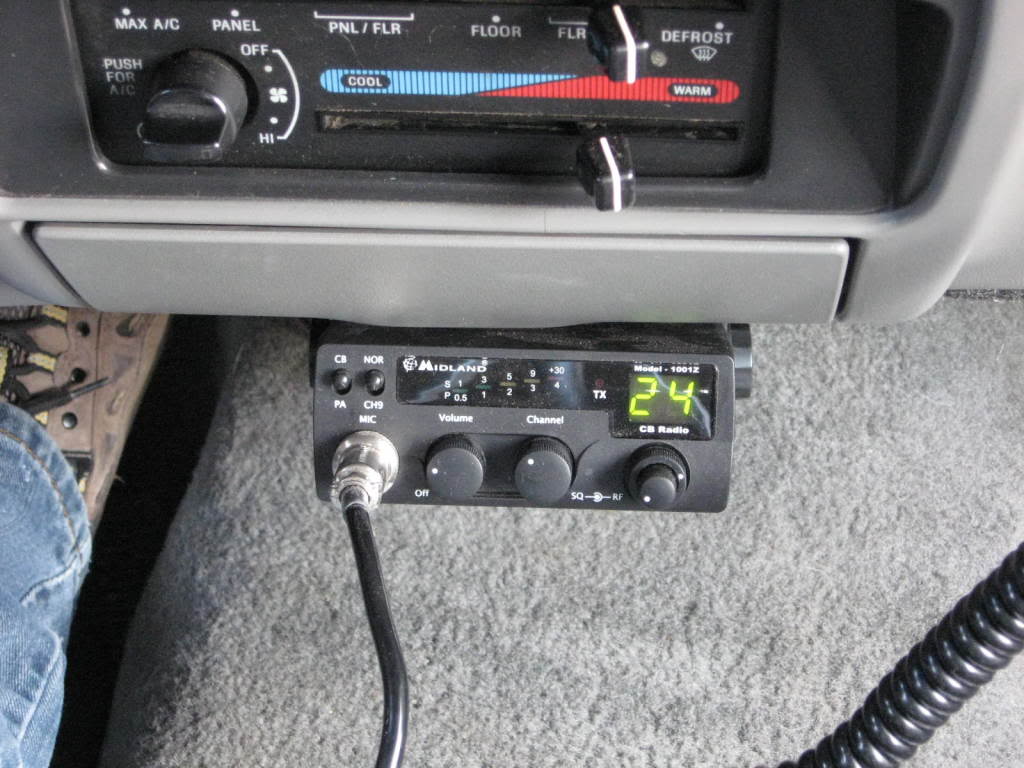

Here's my old setup...
Cobra 19dx iv mounted to the ashtray...

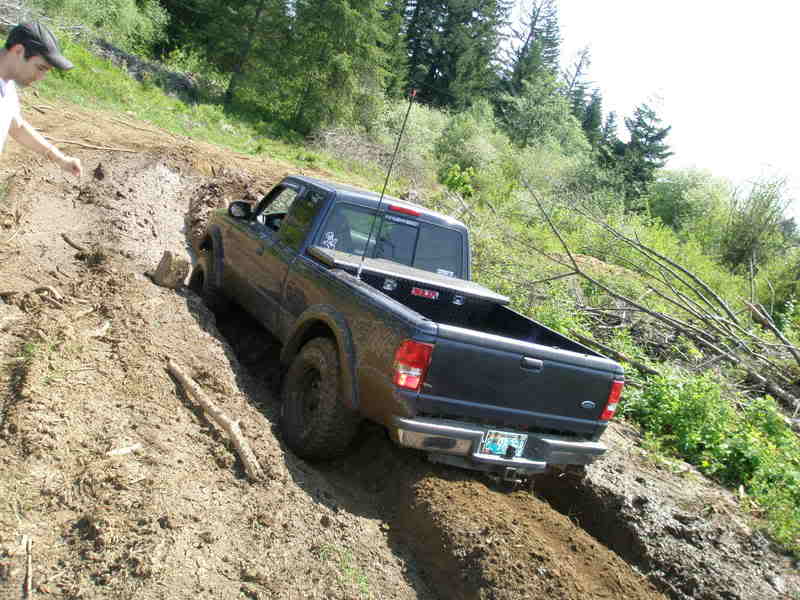

antenna mounted to toolbox using half a mirror mount...worked 'okay' but not good by any means...

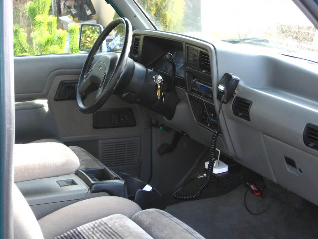

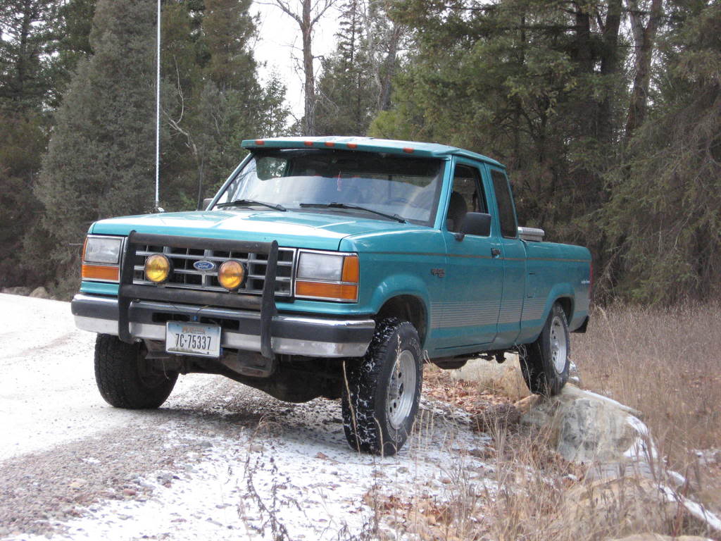

Here is my setup. I stole Shanes hood mounting idea (that, and my dad just laughed at my tool box mount), and mine is also mounted under the dash, like Shanes was:

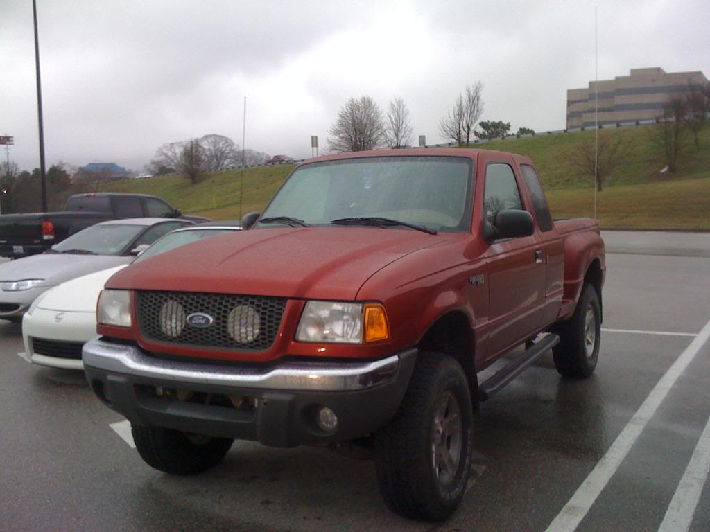

Here is my antenna the truck is wet not dirty btw

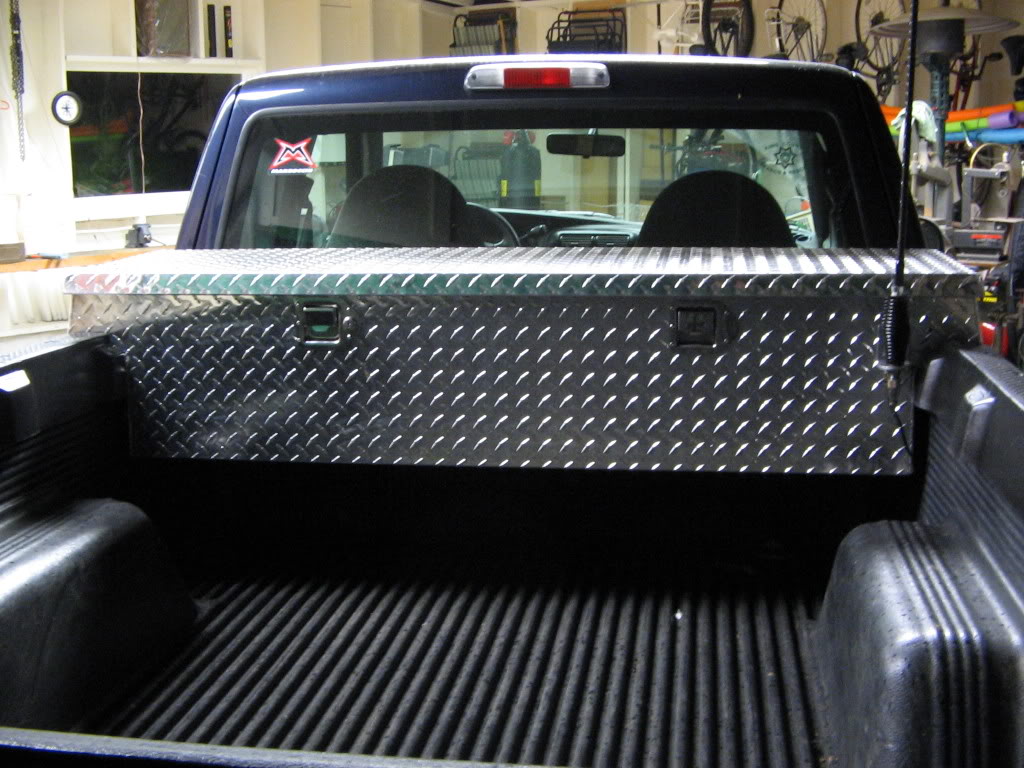

Heres my set up

when you guys have the antennas on the rear of the toolbox how do u run them into the cab?
Old Feb 28, 2009
mikerider's Avatar
Posts: 2,518
From: Renton WA
Mine is bolted to the bottom of the box then through the grommet in the front of the bed, then along the frame passenger side frame rail to one of the grommets in the floor pans then up through the slice in the floor that the pre-tensioner comes through under the floor mat and to the CB works out rather well.
Old Feb 28, 2009
down through the grommet on the front of the bed, then along the frame til i hit a grommet in the cab floor, now we're in the cab...under the carpet, under the dash, up the a-pillar, then above the headliner and plugged into the radio. 18' is perfect!

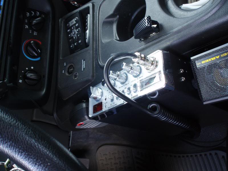

uniden pc-68 ltw peaked and tuned.
wilson 1000 roofmount with 4ft whip
