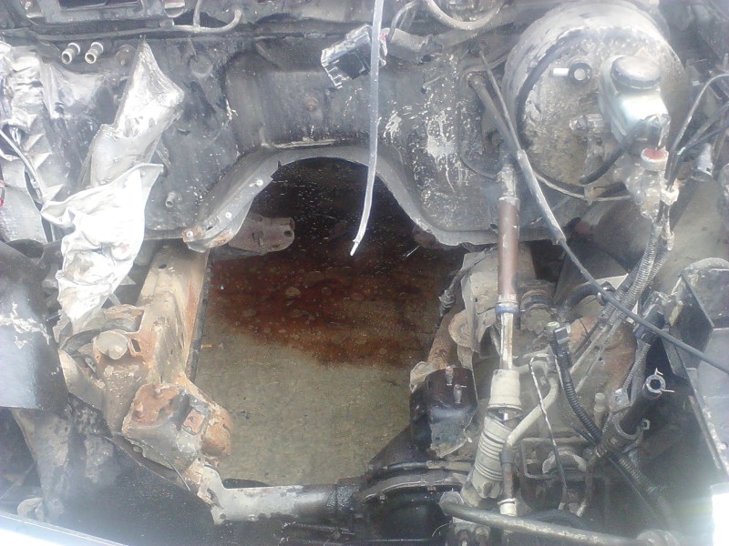

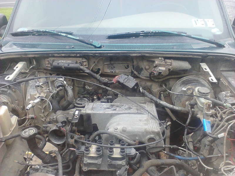

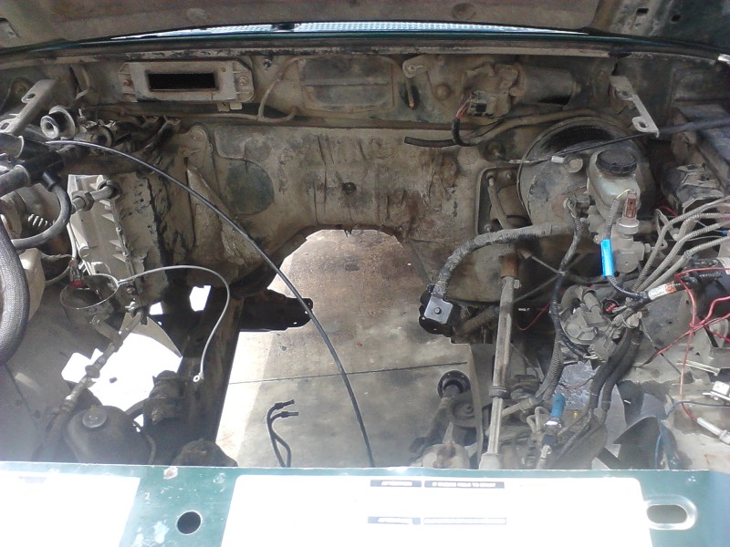

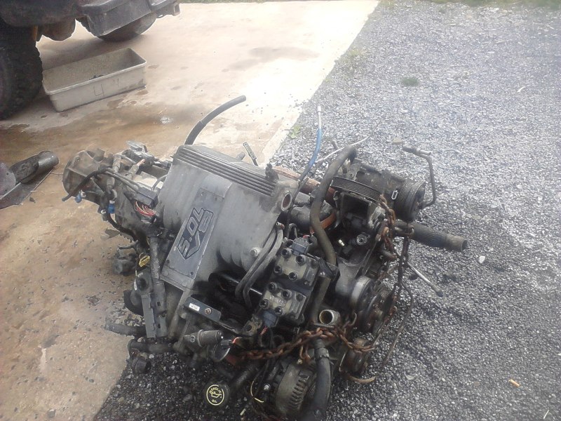

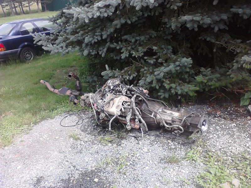

3.0 out
Mountaineer being towed home.
5.0 Out
5.0 In.
Just need to bolt on exhaust and im done.
