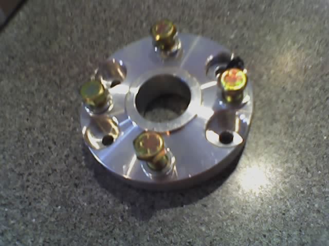

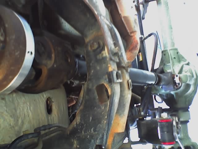

Old 04-03-2007
redranger4.0's Avatar
Location: Firey depths
Posts: 15
that is what jey used to adapt a driveshaft to his tcase. its made by tom woods.
is there another piece missing from that first picture? or maybe i dont understand what it did for it.
Posts: 15
that peice is just an adapter. It adapts what ever size CV jey used to the weird 1354 CV yoke.
Old 04-03-2007
Join Date: Nov 2004
Location: IN
Received 10 Likes on 10 Posts
just to make this clear.
when you say CV that jey used you mean a Double Cardon Ujoint?
because in my situation i see that piece/adapter, then anther piece then my Double Cardon Ujoint then the shaft.
Jey is not using a "CV Joint" like what the stock ranger has right?
If I had the piece that bolts to the other half of the Double Cardon Ujoint and it didnt match up to my Tcase that is no problem i would just make my own adapter.
