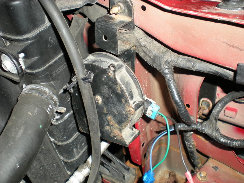

To get it this far in the pictures you’re going 2 add one of the pig tails to the stock horn wiring. Make sure its long enough 2 reach below the support for the air box, because that’s where you’re be bolting it down.

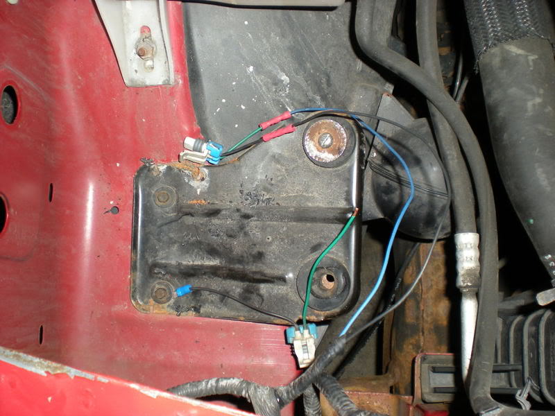

To connect the second horn wiring harness you’re going to use a purple splice connector take it to the power side of the wires and clip down the connector. For a ground u you’re going to pull one of the bolts up from the airbox bracket and the wire under it n bolt it down nice and tight

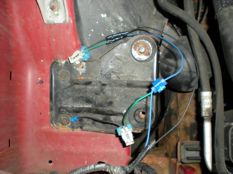

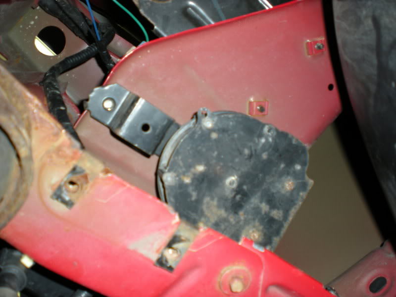

This is where the 2 horns will be mounted after you’re finished with the wiring on the passenger side.
Once you’re that far test the horns out 2 make sure they work.

the second to last picture, can you get a better angle to see where it should mount?
THAT'S MY TRUCK!!! COPYRIGHT IN FRICTION!!! Dan you can check it out next time we are at Daves (FMD) or where ever...
