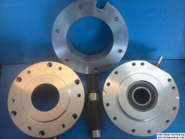

Picked up some 4340 chromo front shafts and 35 spline yukon hardcore hubs for the front along with a ford NP205 to mate with one of the 1356 tcases I have sitting around.
One of those fancy box pictures

Well things changed a bit. V10 is now going into the superduty which threw a rod. I have a new house and need a plow truck without question, the beat up superduty fits that build pretty well. The 5.4L should be hopefully good enough to rebuild, if not the blocks are plentiful. I have also gotten my doubler parts from behemoth along with the NP205 brace.
Ranger+V10/ZF6/NV271 loaded up for the trip from Houston to SD.
NP205 brace
NV271 doubler housing
Attached Thumbnails 2005 edge dana 30 4 link swap-20130901_175632.jpg   2005 edge dana 30 4 link swap-13050695001282.jpg   2005 edge dana 30 4 link swap-13081695002.jpg   2005 edge dana 30 4 link swap-13081695004.jpg
