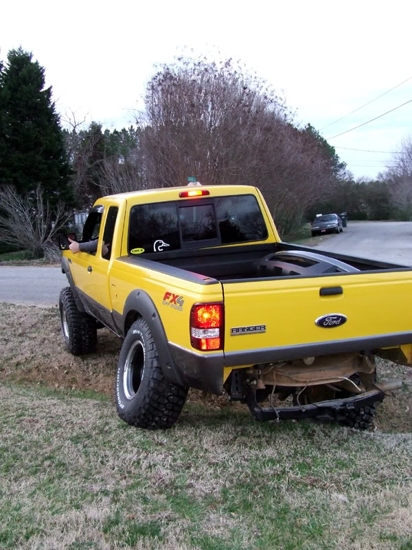

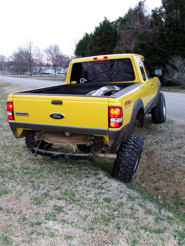

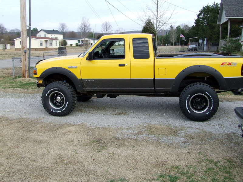

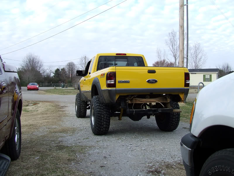

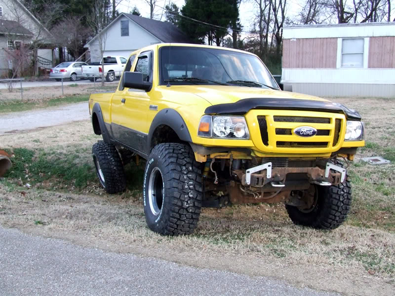

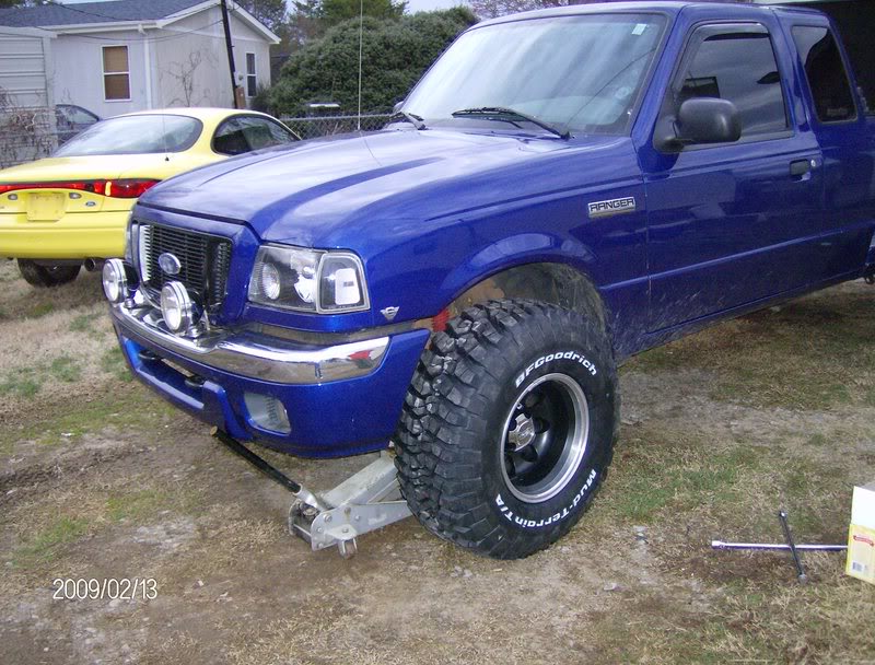

Well its 95% complete. Still have to get the front bumper on and the rear. Which we will take care of next weekend. Ran out of time to finish it. So here is the pics and a vid.

looks great, the new km2s look awesome on there

Nice flex. Get those bumpers done!

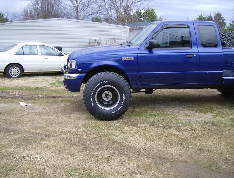

here's a few pics we got of mike truck with my 33's on it....

I think some 33's and black wheel may be loomin in the future!!

Looks great!!! One suggestion though before you put the front bumper back on. Paint the bumper lift brackets and part of the frame they attach to black so it doesnt stick out when the bumper is back on.

Cool!! Thanks for the heads up..i didn't think of that!!
BTW: for those that wonder.......front from ground to bottom of fender is 40 1/2" and rear is 41 1/2". T-bar crank and shackles.

Something to note as well...... take sandpaper or a grinder with a flapwheel disc on it....take that zinc coating off those front bumper brackets. paint dont like to stick to that zinc stuff for too long. paint the brackets. paint your front x-member, then install your bumper. IF those welded on studs break, bolts look WAYY too ugly to me...I used 1/2x1 1/2 allen head bolts on marie's. Very nice and very clean looking....since you'll see it through the hole in the bumper.

OK....seriously....paint those caps the same color as the wheels but with a chrome oval. it's BEGGING for that to happen!! all chrome cap is too much in that area imo....doesn't flow too well with the truck imo...with the DSG and flares and whatnot.

Please remove those tow hooks and don't cut the valance. Or get some level II hooks. Those are just some regular hooks and won't look real good with a cut valance.
But other then that it looks real good.
